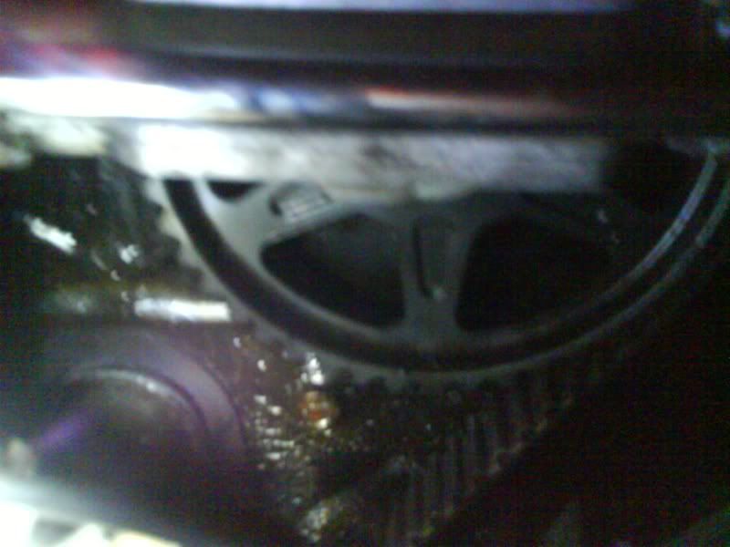

    I'm leaking anti-Freeze looked like it was coming from thermostat housing but it also looked like it was comming from behind the pulleys. so i took off the plastic cover under the head cover and where the timing belt was covered with nasty stuff...oil...grime...possibly antifreeze, but my antifreeze is clean and i dont have a ton oil leaking anywhere is it suppose to be like this or clean? what do i do. the thermostat housing gasket was shot do i just replace it and see what happens or what else do i do.

      k I replaced thermostat and seal around the housing. Ant-freeze is still dripping all around the two pulleys and the area where the timing belt is.
      a lot of it is coming out. What do i do? i really wish i could get someone to look at it that knows what there looking for. There is a ton of oil build up all under the pan and stuff, but the car doesn't seem to be leaking oil.

            RE: Leaking anti-freeze
            Hmm..I'd be pulling that apart and checking the water pump.
            If the water is coming from above the water pump then I'd be looking at
            the t-stat neck. (bottom left of pic)
            A head gasket issue is also possible.

              Thanks yea tomorrow i'll probably be pulling all that off i'm kinda nervous everything i do is a learning expireince and i've already broke the head off one of the screws holding a pulley on, but i'll tap it and just take it step by step
