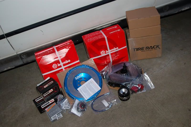

          Got some new stuff. UUC poly trans mounts and steel braided clutch line.
          92 BMW 325is #5 ITR
          Dive Motorwerks
