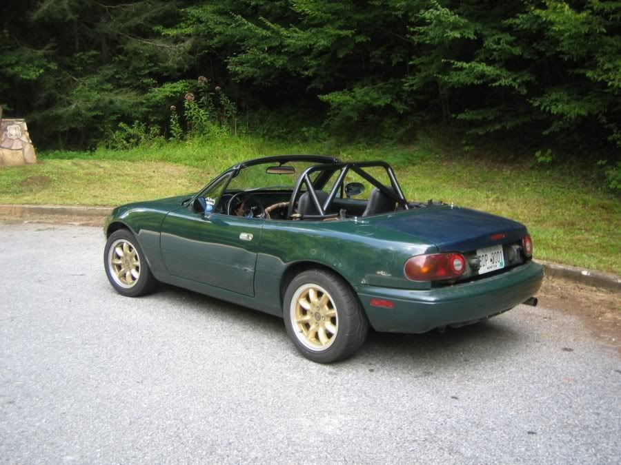

    Figured I should pitch in. So here's the "bike killer".
    So she stayed all stock for the first month or so, aside from the wheels. Then I started tinkering...

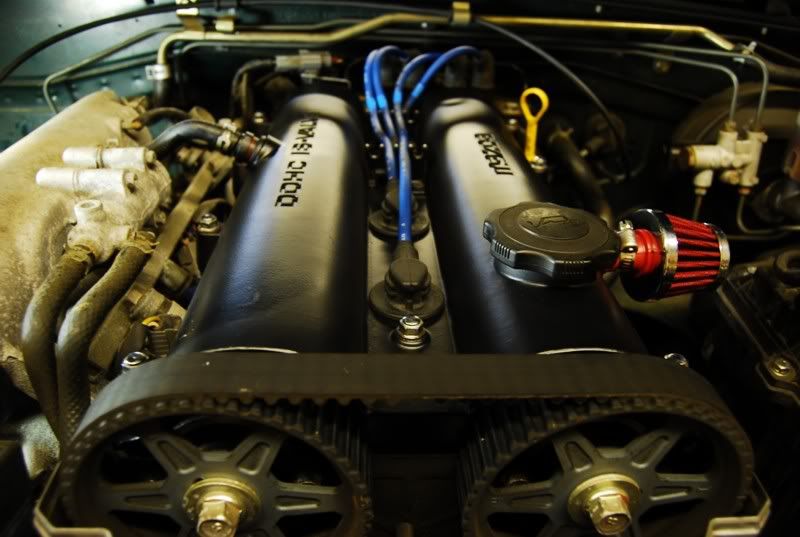

    Machined the front of the VC off. If anybody wants one of these done I'll do it dirt cheap. :)
    A few of the folks on here know of my obsession with light weight. If you can toss it up in the air and it comes back down, it's too heavy. Thus:
    Just got my Azenis mounted and picked up a Hard Dog HCDD for cheap. The wheels are going on tomorrow, and the rollbar goes in as soon as I make backing plates and cobble together the right bolts. The bumper cover is currently being modified to allow for a center exit exhaust to be fabbed up.
    Then comes suspension, brakes, and then the power mods. Still debating between a 7lb. JRSC + some motor or a 10lb. with lower compression. The general consensus seems to be less motor, more boost, but there are pros and cons to each. I'd like to think I'd be happy with 200hp and a lot of weight reduction, but who knows. Might end up going even crazier in the long run. :)

    my oh my, the miata dot netters would have a fit if they saw what you are doing to a 91 brg!
    Are you going to put any of the interior back in or truely go bare bones?
      RE: '91 BRG.
      I think that makes it all the sweeter! :lol:
      You know my stance on the interior, but the fact it would infuriate so many shifts my position a bit. The end result is going to be spectacular though. I imagine it to be on a similar level to the exige.

        BFH, I'm keeping the door panels, simply because I don't think I'd be able to make a replacement out of aluminum that's any lighter. A stock black dash will most likely make it's way back in, but it'll be pretty well cut up and trimmed to lose the now unused parts. Going to make a gauge face out of either clear plexiglass or aluminum for the center dash to house all of the auxiliary gauges to come (Water temp, air/fuel, boost, oil pressure).
        The ragtop will probably stay for now. Never know when it's going to rain in the mountains.

          It's got a Montego trunklid on it right now, courtesy of metalman. Wanted to lose the trunk rack and BRG body panels don't seem to exist, so this was about the next closest thing.
          It's going to get all torn down over the winter to be repainted and get all of the hail damage and other dings repaired. The interior will be painted body color to make it look more uniform.

              Ah I do like your car, if mine wasn't so nice it would be torn down like yours for certain.
