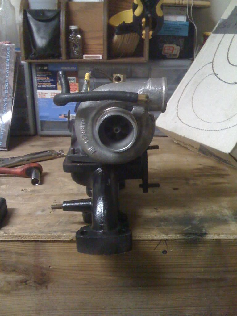

      mmmmmmm boost. whats the trim on that turbo?
          not 100% sure. I got it from Ben today, it is small. I think it is the size of a 2554 only a journal version. The last person made just short of 200whp on it so it will be a great starting point.
            Hmmm... that means you can upgrade the fuel pump and run stock 94-97 injectors for 7-9 psi. :)
              yepo yepo. Currently it going in with a FMU and going to run low boost, looking at 5psi to start with but the end goal for this turbo is 12 psi.
