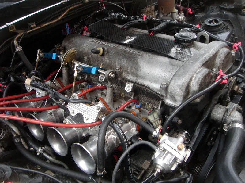

    The ITB kit a set of 45mm throttle bodies with 50mm air horns from fuji racing. It won't run without some kind of engine management, so I built a megasquirt for it too. Ironically though, the first thing I did to the car when I bought it was the rollcage. I figured, get the hardest mod done first, right?

    As for the ITB's, here's how the install went:
    STEP 1: blindly wrench and pull away to your heart's content until your engine bay looks like this
    your garage should be a wreck, and have random seemingly critical miata parts lying around, like this:
    I got rid of a couple of totally unnessecary things during the install:
    then, just slap em on!
    its just a matter of running all kinds of lines and hoses and engine management headaches after that.
